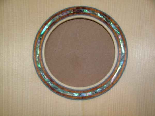

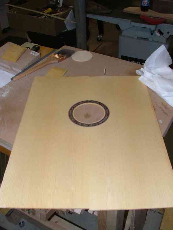

Well I finally applied my nose to the grindstone and knocked out another rosette and top plate for the OLF guitar.
2 questions.
1) Who is finishing this guitar? I would like to have a brief email conversation with you to tell you about a little spot that will need drop filled.. (oops.)
2) Matt, can you send me your address so I can forward this on to you?
It isn't much to look at right now, and my photography sucks, but here are a couple of images.

Looks good to me! Beautiful top! and the rosette looks nice as the last!

Another outstanding rosette, great job Brock.

[QUOTE=LanceK] Looks good to me! Beautiful top! and the rosette looks nice as the last![/QUOTE]
Thanks. The koa is not quite as wild as the last one, but it looks really nice.
And this top plate is Carpathian rather than Adirondack like the last one one.
It pings really nice....

Couple of things about this top. I think it is at about .13xx" currently, if you thin it more do it from the back. The rosette is ablam and I am not sure how deep the colored layers are...
The pearl is a little low in one spot (it looks like a layer might have chipped out). It looks ok visually -- it is very hard to see, but when it gets finished it will need a drop fill here.

1) Remember thin it from the back. I have concerns about how many ab layers are left in the rosette.
2) I did not round over the sound hole. If you are going to take a lot of thickness off of it, I thought it might be better to do this after it hit final dimensions.
